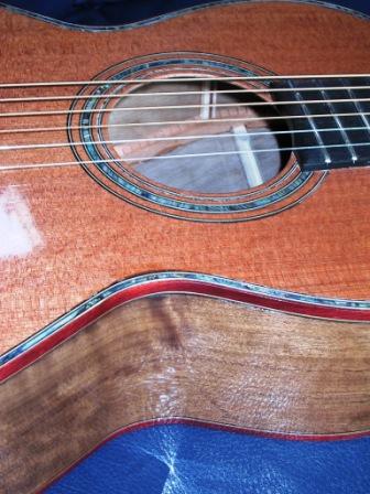

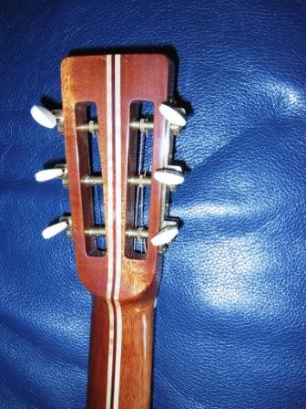

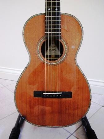

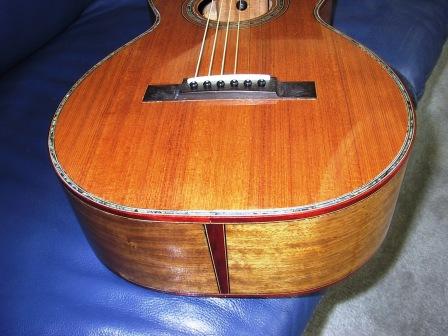

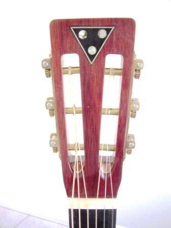

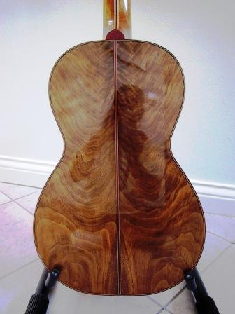

It's been completed for a while now and I was going to design a quality photo setup but time has just marched on. Nevertheless, the record pics will have to suffice for now.
This is a twin brother to a Cherry and Sitka model (#4) that I'll post when I have time. They were built at the same time and are 2 completely different sounds. It was quite an education.
Here are the specs:
-Parlor Style...Scott Antes design with a larger soundhole and slightly deeper body
-Redwood Top...Don Williams
-Walnut B&S...Zootman
-Bloodwood bindings, Headstock & BS...Zootman
-Abalam Rosette and Purfling
-Mahogany neck with M/BW/M laminate
-HHG on all body joints
-Adirondack Spruce bracing
-Epoxy on FB to neck
-KTM-9 finish over Zpoxy & shellac
A special thanks to John How and Hank Mauel for their fine examples, inspiration and advice.
Here are the pics:

How wide is that paua purfling, may be the body size but it looks wider than .06, like maybe .13 Sweet looking guitar

Wow! She's a beauty! That top had a lot of silk eh? Pretty. So we all want to know how it sounds...?!

Michael...The Abalm is .098" on the rosette and .063" on the purfling.

The sound...Well, when I first strung both of them up I was somewhat disappointed. I believe I was so used to the bigger sound of my 000-12 fret that I couldn't appreciate the parlors for what they are. After a month of playing them, I have a much better sensitivity and actually like both. The redwood is brighter and the sitka is bassier. I am most pleased with the playability of both. When my brother arrived from Dallas to pick up his Sitka/Cherry he was blown away by the sound that it has. He actually preferred the sound to my larger 000-12...go figure. I have a real hard time describing sound...you'll just have to pay a visit and play it sometime!

I love the figure on the back....

Love the walnut JJ. Nice Work

Love that Walnut figure.
